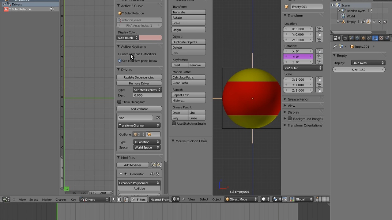

im on blender 2.79 and when i hit to enter the driver the options are different. i tried all of them, and the cursor changes to an eyedropper tool... whatever i picked doesnt turn to purple and not showing in the drivers tab :(

*@akjlleas* Hi there! I am using Blender v.2.80.45 and I can follow the tutorial :). The "Add single driver" option has disappeared but you can still use "Add driver" and edit it without opening the Drivers Editor.

Hi, I'm new to Blender. I am using Blender 2.80. I am not able to add drivers. It's not working as you said in the tutorial. It's on Y rotation of Empty Plain Axis. It says Invalid Python Expression. What should I do?

*@Md. Abdul Aziz* Oops! I may have selected two empties and add a single driver to both of them at once. This time it worked fine.

Now in Blender (I've got 2.91.2) is the driver stuff much simpler.
Gerald Schlüter
Jan. 24th, 2021
Select the empty square. Get the sidebar with N, Select the Item Tab and right click with your mouse on Rotation Y. Choose "Copy as new driver". Then select the empty cross. Right Click on Rotation Y. Select "Copy driver". Right click again and select "Edit Driver". Change Type to Scripted Expression. In the field unter "Expression:" enter "- rotation_euler" (put a - sign in front of it). Thats it. You're done.

In Blender 3.3+ you have to update the Owner space of a ball in constraints. Change it to 'Custom Space' and set object to Cube
Ekaterina Levchenko
March 15th, 2023
In Blender 3.3+ (my version. might be previous versions too) to add a driver right click on rotation y in transform menu. Click 'Add driver'
Choose Drivers editor as the view for the left of the screen (instead of Graph Editor)
The new driver will appear on the left of the driver editor. Rest of steps are the same
