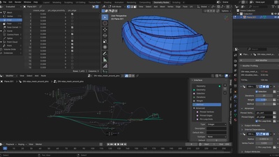

Add them to one of your asset libraries. More info in this detailed tutorial on node tool assets. They should then show up in the Edit Mode header menus and the modifier list.
Add the "GN-visualize_mesh_pinning" modifier to your object to see the pinned geometry. For now only open mesh boundaries will automatically be pinned and appear as blue. Tweak the size sliders in the visualize modifier to your liking.
The modifier "GN-relax_mesh_around_pins" is relaxing all geometry that isn't "pinned" (More on that in a moment) and should be located before the visualize modifier.
The default 10 Iterations should be enough to get good results. Adjusting this value makes the relaxing stronger but also slower.
The Methods value is to change the general smoothing behavior. This is something we are still testing.
From here you use the Edge menu (Ctrl E) and Vertex menu (Ctrl V) to pin selected vertices and edges. These will appear magenta via the visualize modifier.
There's also the option to bump the "Proximity Level" to 1. This will automatically pin the neighboring edges. Very useful for holding a crease on a subdivision surface.
Relaxing can also be used on the selection from the menus. You can find this in the Mesh menu and even add it to a shortcut or the Quick Favorites for quick access.

Ideally first focus on broad topology and key loops where they have to be. Don't use the modifier for relaxing yet. Only use the visualize modifier.
Mark edges with various colors depending on what function they serve. Use Seams, Creases, Bevel Weight and Freestyle Edges.
As long as you know what they mean. This will also make it easier to reselect them later on.
Once you're happy with the general topology select the marked edges again via "Select Similar" (Shift G). This way they can quickly be marked as pinned and optionally with proximity loops. For the proximity loops it's best to "Bevel" or "Loop Cut Offset" the marked loops.
Add the modifier for relaxing and start adding all the filler loops to
  • Support shape curvature for subdivisions
  • Prevent stretching
  • Allow deformation via the rig
All these new loops will be automatically evenly be distributed via the relax modifier.
If there are any relaxing issues try pinning some additional vertices or edges or change the relaxing "Method" in the modifier.
