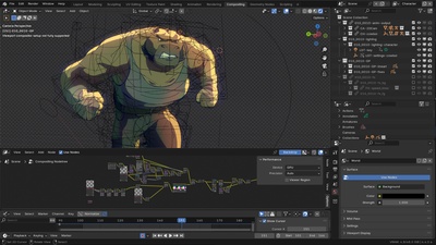

I wanted to have the model looking 2d, I knew i will have to do 2d touch ups with Grease pencil, but I wanted to have already some of the 2d build up in the model by default.
First I defined the lines I wanted to be on the model all the time, we were going to use lineart for the line work on the character, so I when in the geometry of the Cowboi and I selected the edge I wanted to show and I mark them as freestyle, that will allow the lineart to detect them and show them.
Second I use some build up shadow that are going to be always there, mostly top light shadows, like under the eyebrows, nostrils, lower lip. inside the ears, under chin, also some on the t-shirt and the pants and boots. we did this by creating a mask and painting it in vertex color.
Sticky GP
I knew this was going to be the main thing will make all look 2d, (of course the rest of the things add to the entire effect).
We decided have a light that gave us some shadows as a base, when we were happy with the light direction and the amount of shadows we lock that up.
Now I needed to make the touch ups to shape that shadows into something with more style with Grease pencil, in this case, most of the shadows were pretty round (normal because is following the topology of the character) but I wanted to have them more blocky and graphic to emulate the 2d anime style.
I didn't want to have to draw each frame, but instead I wanted a way to make that strokes follow. so Simon created the sticky GP tool, still in prototype, but that was exactly that, you draw something, you stick it to the mesh, and it follows. In poses that are similar works perfect, you can even unstick them and reposition the strokes a bit.
when the pose change a lot, that strokes will still follow, but probably you will need to create new one because is a another pose and the strokes before wont work.
I divided the touch ups into different parts of the character to have more control over them, i did the head, neck, left arm, right arm, t-shirt, pants and boots.
And within each part I created a light and shadow material in grease pencil of the shading, like the skin, beard, mouth, shirt, pants, etc. to be able to paint over the current materials.
Later on render view I started to draw over the default shadows and making the adjustments I wanted to do, sticking the strokes and repeating.
At the moment the sticky tool has some problems, one of them is when you stick a stroke and some points don't stick properly for different reasons, one of them can be they stick in another part of the mesh that is closer to camera, for example a arm being in front of the shirt.
Other reason is some points go to the center of the world because they are painted out of the mesh. In both cases I took the points were not sticking properly and dissolved them in edit mode.
I also encounter some problems with the different types of brushes, I ended up using the marker chisel with the material just with the fill, I couldn't paint the blocky shapes with a normal stroke, so this is the solution I found.
This also create some problems, because fills are flat and the model is not, so if the fill was big, some geometry was popping through, I fixed this by creating this big fills and where the mesh was sticking out I created smaller fills until all was cover
we will work to make this tool better, but you already can see a good result

Excellent work, gentlemen.Did you use some type of post processing to get the gradient lighting on the characters?
Pablo Fournier
Pablo Fournier
Nov. 24th, 2025
@Jesse Cowan only the highlight and small rebound light is made in compositing rest is all drawn by hand, also the speed lines and the rotate bg lines are made with geometry nodes

Do I need Blender version 4.4 or I can use 4.3 for Sticky GP?
Pablo Fournier
Pablo Fournier
Dec. 20th, 2024
@Mateusz Andre 4.3 should be good

Do we have any access to Sticky GP? :)
Simon Thommes
Simon Thommes
Dec. 18th, 2024
@Lael At this moment Sticky GP is only a loose prototype. You can find the setup in the 010_0010-lighting.blend file of the packed shot that is available for download at the top of this article.
Eventually we want to develop it into a proper tool that doesn't require any setup and make it available as an addon.
For now the process is unfortunately quite cumbersome:
To make use of it, you can copy and paste the FX-stickyGP object into your file and point the modifiers on it to the collection of your character. Then (after reloading the file) in GP draw mode you get the Sticky GP - Stick/Unstick operators in the Draw menu.
You do need to make sure to have a UV map called GNSK on all objects of your character without overlaps. This doesn't need to be game-ready or anything a simple auto-unwrap will do.
