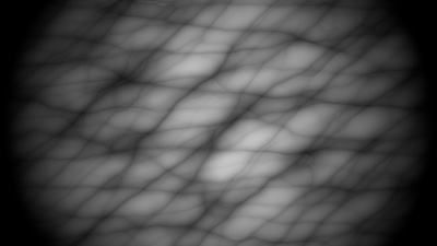

Kent Trammell from CG Cookie was so kind to share some of his skin textures with us under the CC0 license. You can download and use them for you own needs as well: CGC_skin-stamps_CC0.zip
Sculpt tertiary details on individual sculpt layers!
That includes skin details like pores, wrinkles, aging, complexions, etc. This is very important since this will help to
