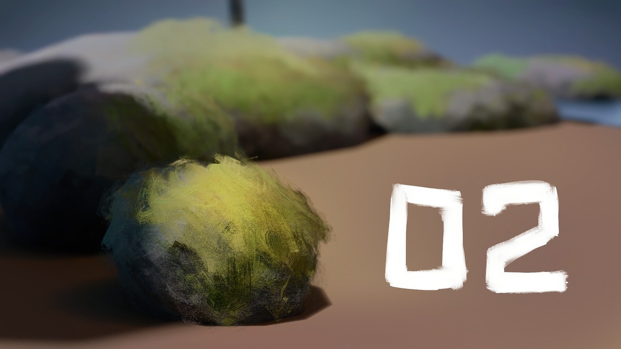

After the basic fill layer setup, here is an introduction to the draw layer. The draw layer gives you precise control over the brush stroke placement and also provides tools for procedural generation to generate complexity from simple brushstroke inputs.
