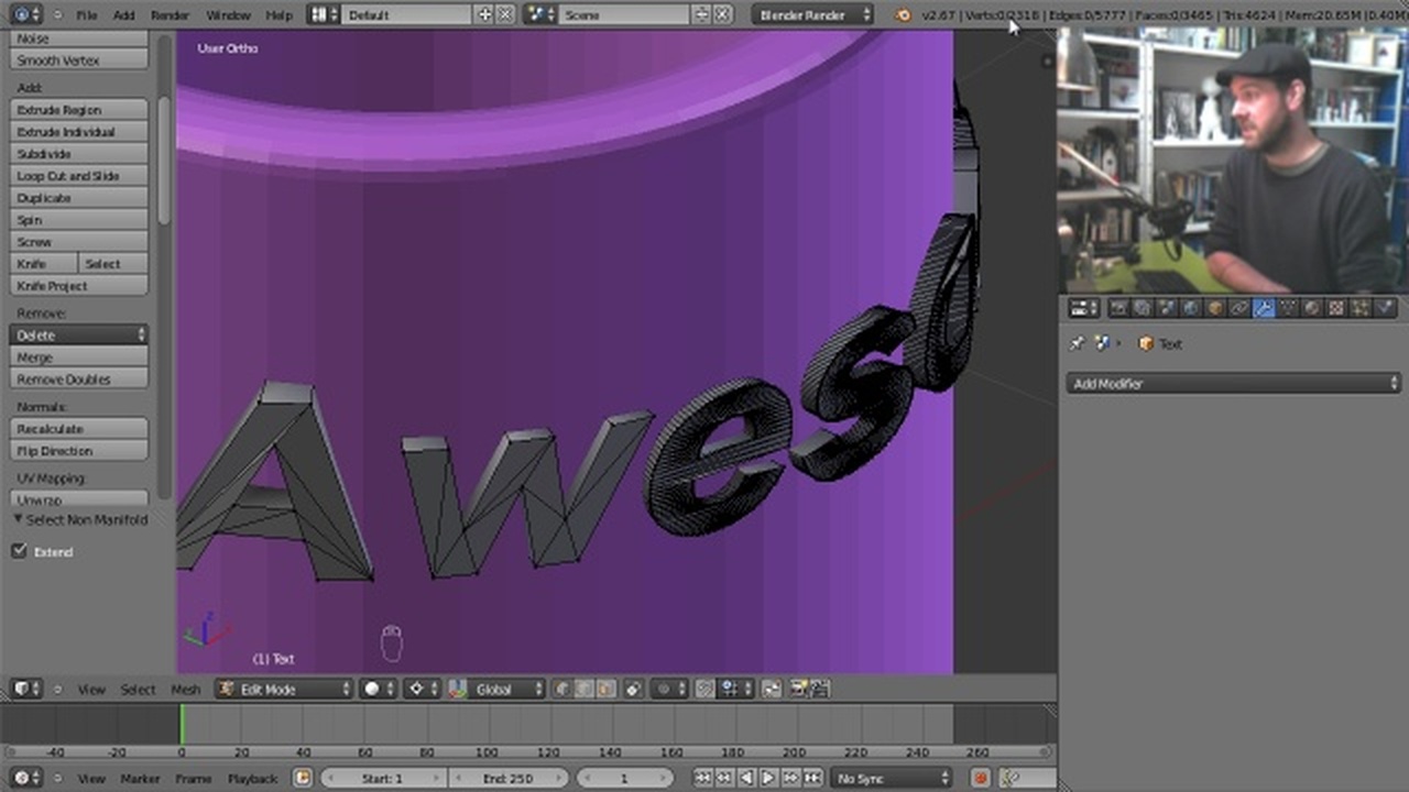

I don't have the non manifold menu item in select, do I need an add-on or is it because I am using version 2.79?
Julien Kaspar
Dec. 15th, 2017
@jcarlyle: I think they reorganized the menus in the "select tab". You can find it under "select" -> "select all by trait" -> "Non-Manifold". You can also do it with the shortcut "Shift + Ctrl + Alt + M"
dave.cassidy
Nov. 23rd, 2020
@Julien Kaspar : Do you know if "Remove Doubles" has been moved in the reorganization as well or if that operation has a keyboard shortcut? I've searched for it without success.
Julien Kaspar
Nov. 24th, 2020
It got renamed to "Merge by Distance". You can find it in the merge menu on the shortcut M or in the right click context menu (or W on right click select).
