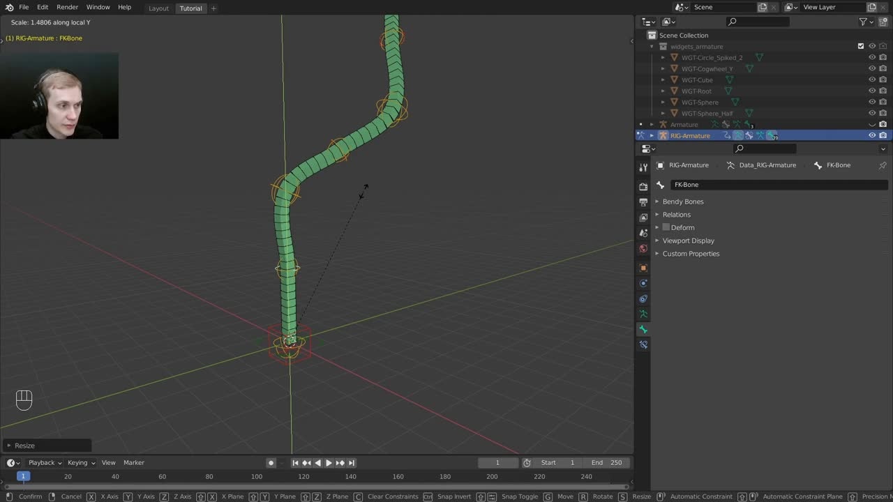

FK chains are simple enough, but let's see how we can make them complicated with features like FK Hinge and automatic deformation testing!
