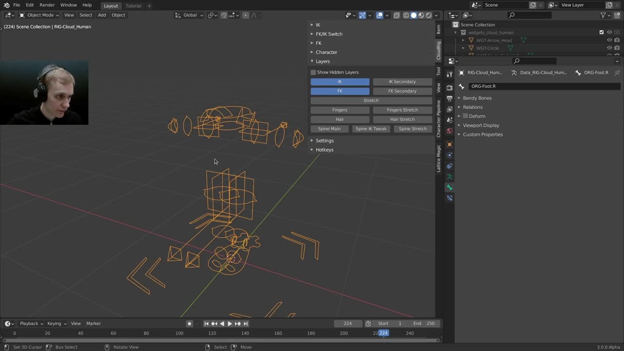

CloudRig provides a bit more granular of a system for organizing your bones into different bone groups and bone layers than base Rigify, and it also handles selection sets differently.
Update from the future: This system has been updated to support bone collections, and adds some handy features to them as well. Learn more on the wiki.
