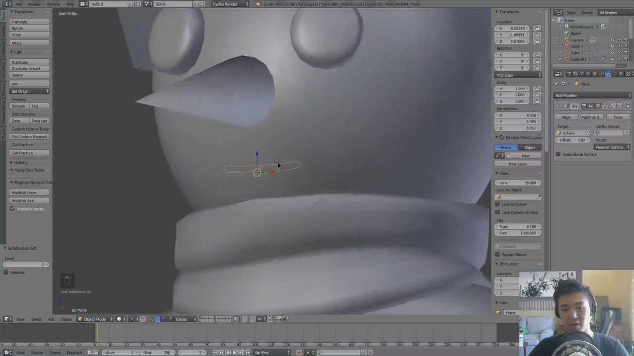

If while applying the Solidify modifier, your Solidify is skewed, [Tab] into object mode and [Control + A] to apply scale.

Hey, Dillon, to make more vertices you could easily select the edge, hit W, then subdivide. Didn't know what you pressed to get the vertices so I had to look it.
Stephen Petersen
Stephen Petersen
June 1st, 2018
@garnogd: loot cut (ctrl-r then mouse roller to add more)

No matter how many times I do the shrinkwrap modifier on the mouth plane, it still won't contour around the head. It just stays as a rectangle.
Dillon Gu
Dillon Gu
Nov. 8th, 2017
@quesogr7: You need to subdivide the plane! Otherwise it doesn't have enough vertices to actually morph to the shape of the mesh.
