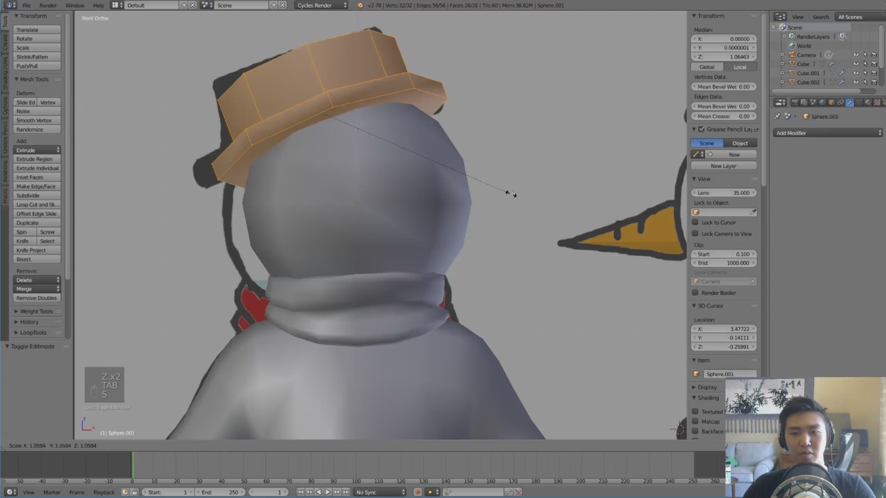

6:50 -> I don't understand why when I rotate the hat, the head rotate also a little bit on my side, while on the video it does not make any movement, just the hat rotate. I have however hit the "p" to separate the circle at the begin of the hat making... Any idea ?

@Guy Capra: Is it a separate object? If it a separate object and you have only one object selected it should work.

@all : hurra! I have found the problem : proportional editing [random] was always ON because I had used it to make the scarf (I made it with a torus and random "G" on vertices in one pass to be quick). So when I rotated the hat, the head moved a bit less, and this made me crazy before I can find my own mistake forgetting this proportional object editing tool in action !

Hello, I have a problem with the scarf, when you have to copy (Shif + D) and then press E, when it is ready, the scarf is transparent on one side. What should I do?

@arayabarrioseduardo: still transparent after the solidifier? Transparency can be caused because of shading setting having the backface culling settings on, but transparency should disapear (hmmm) once solidify modifier is added.

@Stefan59: Oh! you are right. I added the solidify modifier and the transparency disappear. Thanks you.
