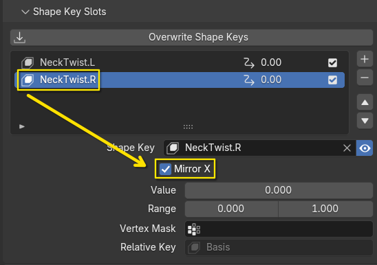

This addon lets you create shape keys that blend already deformed meshes into a previously stored shape. It also lets you manage multiple copies of a shape key together. Each copy can have a different vertex group mask, or be applied mirrored around the X axis.

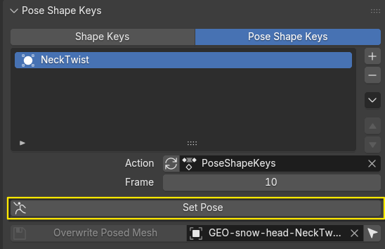

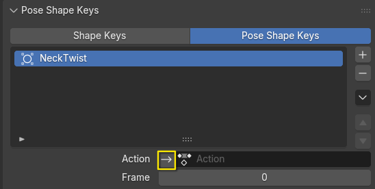

  • Create a pose whose deformation you want to correct. A pose is defined as an Action and a frame number.
  • Create a Pose Key on the deformed mesh. Assign the action and the frame number.

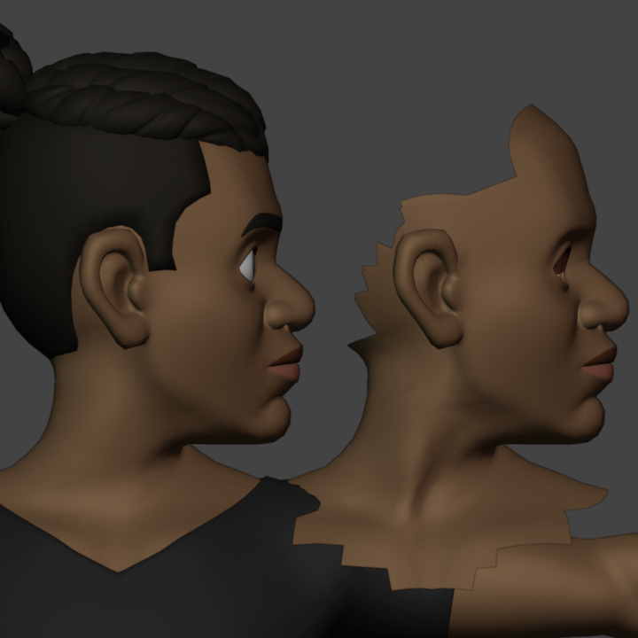

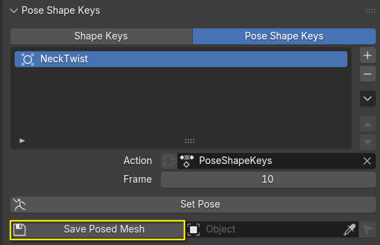

  • Press "Store Evaluated Mesh". This will create a copy of your mesh with all deformations applied.
  • Sculpt this mesh into the desired shape.

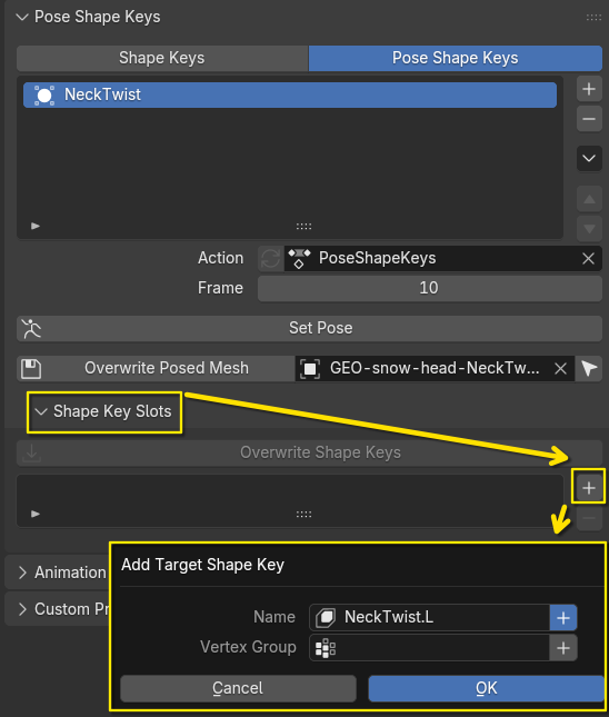

  • Go back to the deformed mesh, and assign one or more Shape Keys to the Pose Key.
  • Press "Set Pose" to ensure that the rig is in the pose you created and specified earlier.
  • Press "Overwrite Shape Keys".

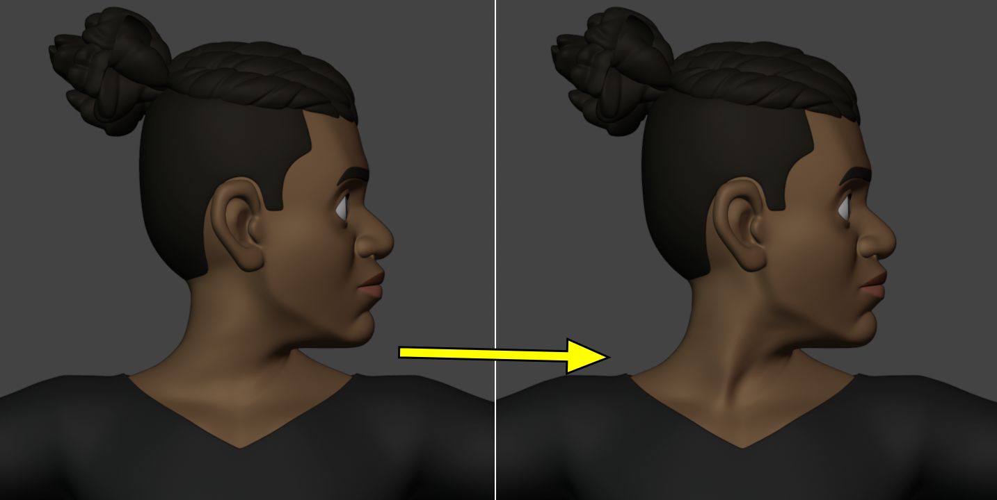

  • When you activate your shape key, your deformed mesh should now look identical to your sculpted shape.
  • If you have more than one shape key, the same data will be pushed into each. The purpose of this is that each copy of the shape key have a different mask assigned to it. This can streamline symmetrical workflows, since you can push to a left and a right-side shape key in a single click.

  • Using the addon, create corrective shape keys that blend your posed mesh into the shape of the sculpt.

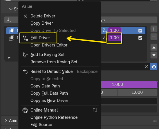

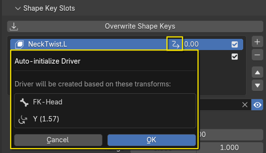

  • Hook up those corrective shape keys to the rig via drivers

  • Create drivers so each shape key is driven by the corresponding finger bone.
