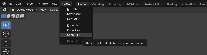

  1. Open your edit .blend file by navigating to Project > Open Edit.
Open Edit
